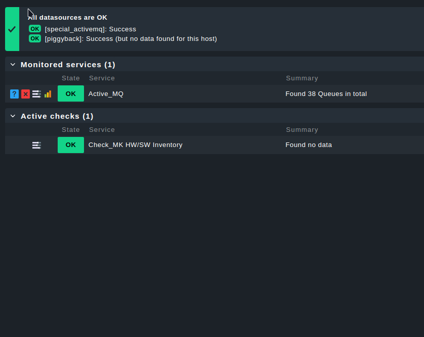

Well i got it working for the one host now, but all the other normal services vanished ?
Maybe you have the Checkmk agent/API integrations option set to “API integrations if configured, else Checkmk agent” selected for your host. I believe this makes the API supersede the agent.
oh yeah! thanks for notifying that option, crossed the box and choose the option with api and checkmk, now it works, thanks all :slight_smile:
Also noticed it was default 127.0.0.1 and not 0.0.0.0 like i found in some activemq documentation.
