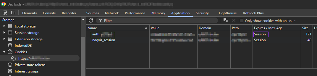

I use following ‘hack / bug’ in Chrome, changing session cookie into date time, to avoid logging into our annoying CRM system daily. Maybe it works for this use case too.
  • when logged in Checkmk web interface, right mouse click inspect
  • go to tab Application, Storage, Cookies, url of your Checkmk
  • you see auth_[site name] as cookie with Expires as Session
  • right mouse click Edit
  • type in year 2 years in the future, so at the moment 2027 will work, press enter
  • Session changes into max possible date / time
:crossed_fingers:
When you want it back to normal, just delete the auth_[site name] cookie, you get logged out and will return to login screen.
