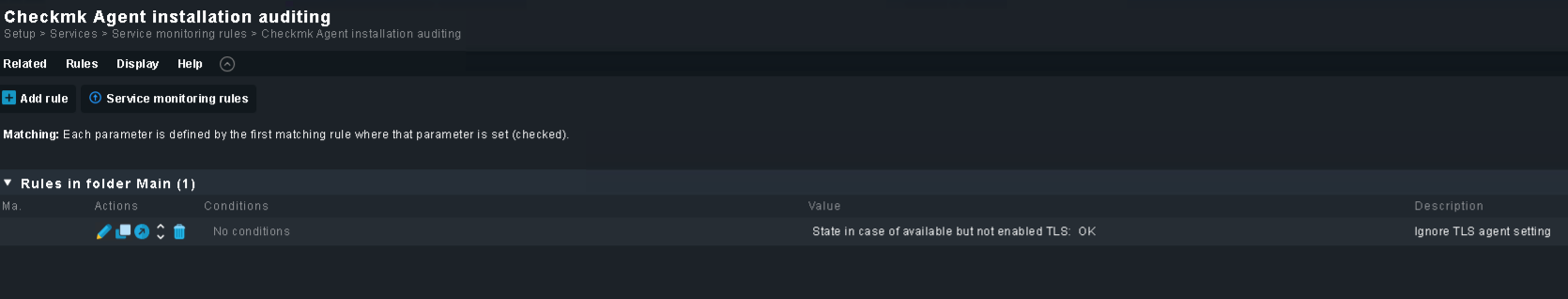

You can use the agent without TLS. You cannot “disable
the service”, as far as I know, but you can use a rule, to
“ignore” the state of TLS registration. Search for “audit”
in Rule search. You could create a rule, similar
to this one:
Push mode is a “paid” feature, only available in the “Cloud” edition
anyway (and in “free”, albeit only for the restricted number of
hosts/services it allows).
