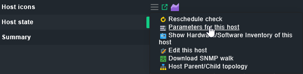

I set this rule explicit on my printer host, so I wouldn’t have weird outcomes on other hosts. But the weird thing is, the rule is not to be found in the hamburger menus Parameters for this ... of the host and its services, which lists all the rules that affect it.
I couldn’t find it other than in Setup > Services > Service monitoring rules > Generic String where I initially made it.
