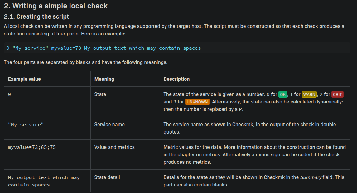

“echo test” is not a local check format for metrics. :slight_smile:
Have you tried to use the proper local check context to create performance data?
for Example:
Docs: Local checks
Hope this helps.
Best Regards
Norm
ah, that explain my problem, changed to
print(“0 test_py - test string”)
and it works :wink:
