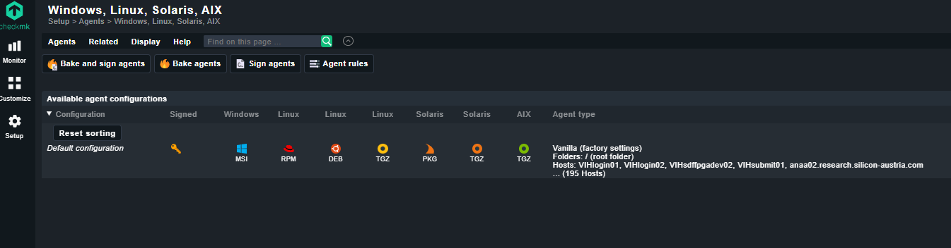

I agree. I also see now that I only have the vanilla available agent configurationleft :
in the past, I had at least one additional agent configuration.
This disappeared now (with an update ?), and basically must be reproduced again. But this is not the problem.

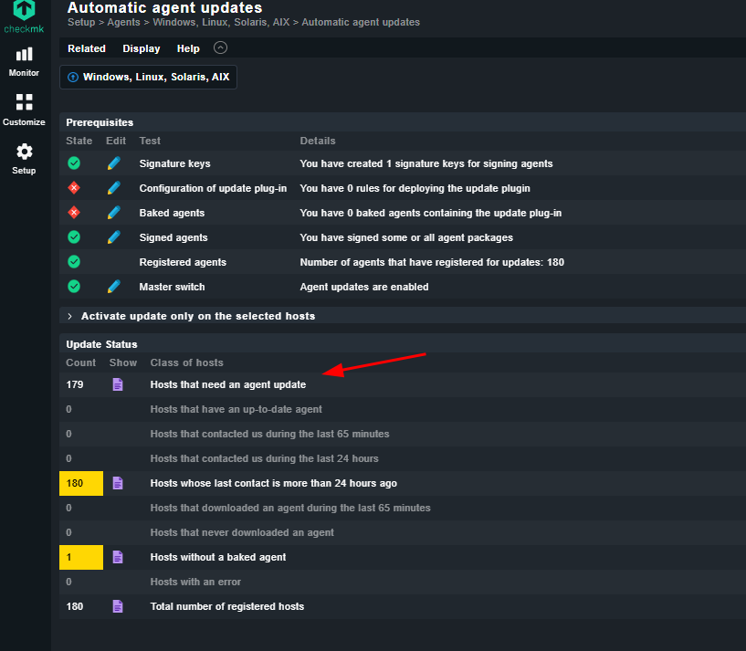

I noticed also the following. Last week I upgraded checkmk server from 2.4.0p26 to p30.
No problem seen. I expected that the agent also update themself (after baking the agent), which happened. So fine, so good.
but the current picture I see is the following
so although all agents were updated to Version: 2.4.0p30 , it still shows need an update.
Strange. I need to escape from this weird situation :wink:

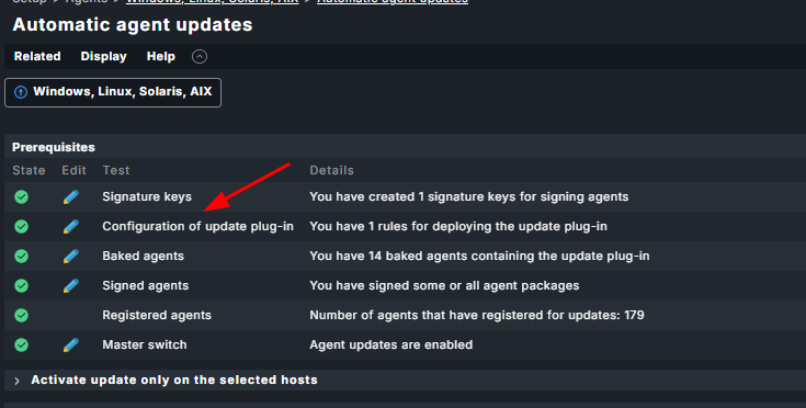

solution was to add a configuration rule, as this was missing :
now the baked agent package includes again cmk-update-agent
