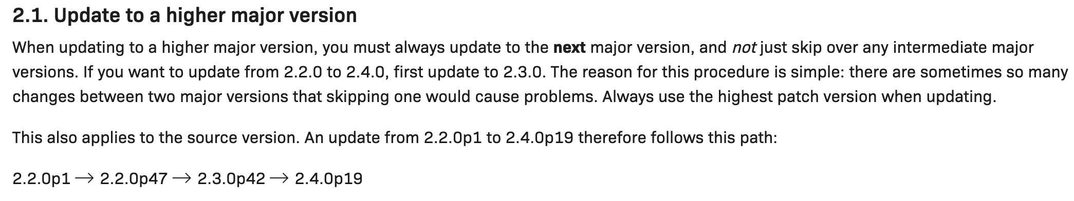

This is from the checkmk documentation, so this is the “official” statement.
There were several occasions in the past where you had to be at least at a certain patch level to update without problems, so latest will probably safest, e.g. werk 15693, where you had to have at least p8 or above.
I agree that this does not have to be enforced in every environment and patchlevel.
I had this with several environments and diferent checkmk versions, that activate changes did not work during the upgrade phase with satellites being one level above the master, but i have not tried it since 2.3 and above. Maybe things have gotten better :slight_smile:
