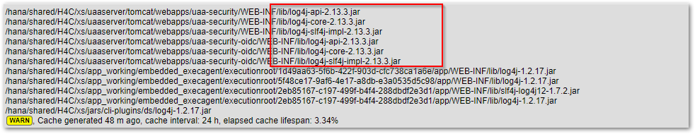

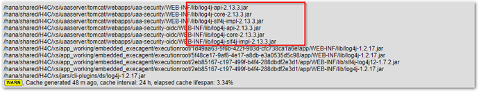

There is now also a a first CMK plugin version available (no local check anymore). You can configure the warn/crit levels via WATO. The output is also a lot nicer :wink:
All the hard work is now done on the CMK server. The Plugin will only run the scanner and forward the complete output to the CMK server.
very, very nice Work. I will test this later. THX!!!
give it a little time, I am working on the full integration in the bakery, so you can than configure the scanner options as well. Like drives, path, fix, timeout, caching time and so on…
@Doc now you can test if you like :wink:
The CVE-2021-44228-log4j plugin is now fully(?) integrated with the bakery (no custom files any more). You can now configure the search path/drives for the scanner via the bakery. There is also the option to tell the scanner to fix vulnerable files. Caching and timeout can also be configured.
