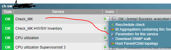

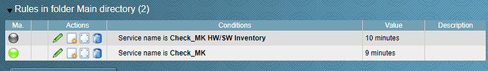

first go to the Juniper
Parameters
edit Rule
that`s it

That helped with the check itself, but the discovery as part of editing hosts still times out at 110s. This is in WATO.
