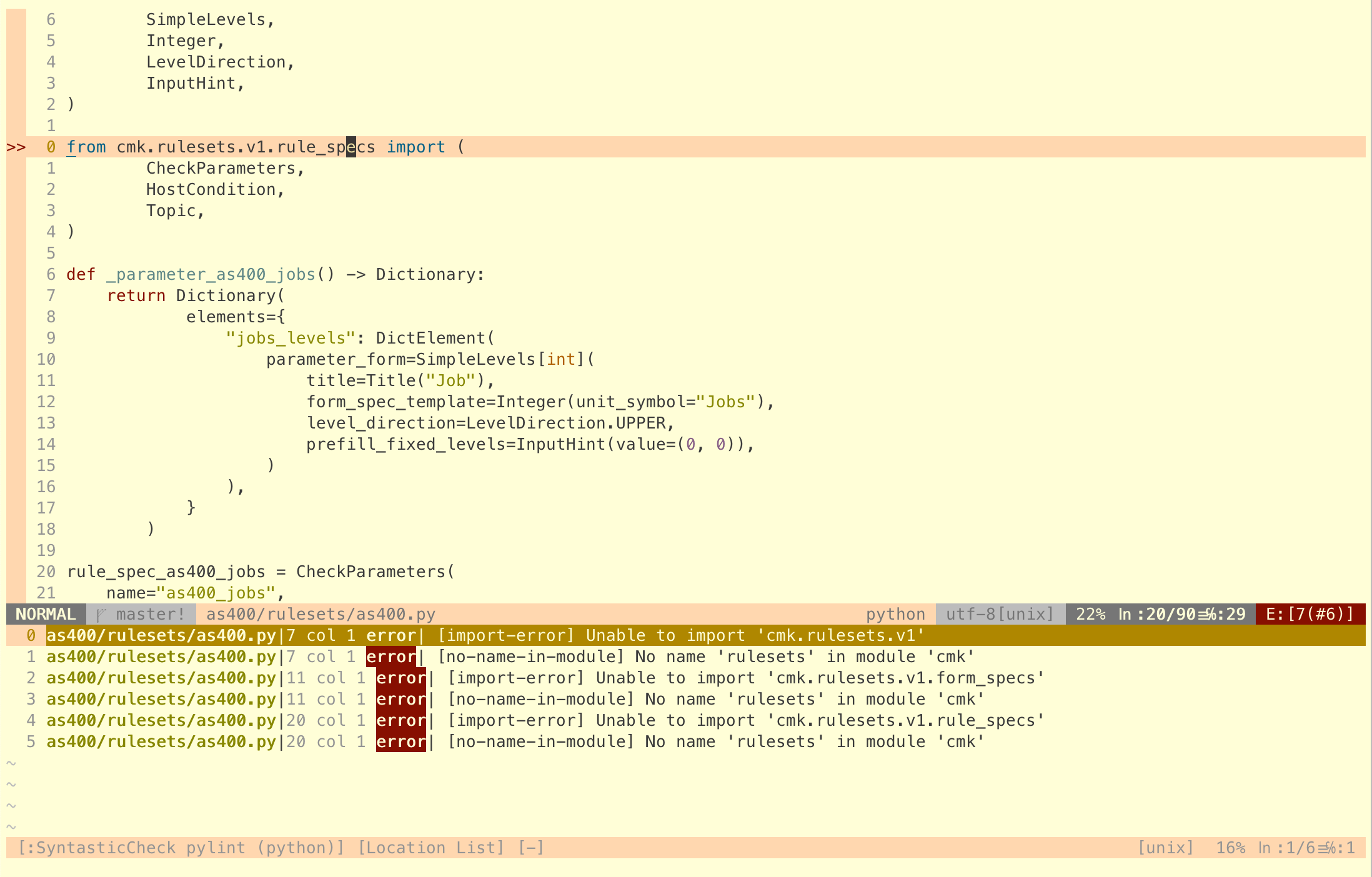

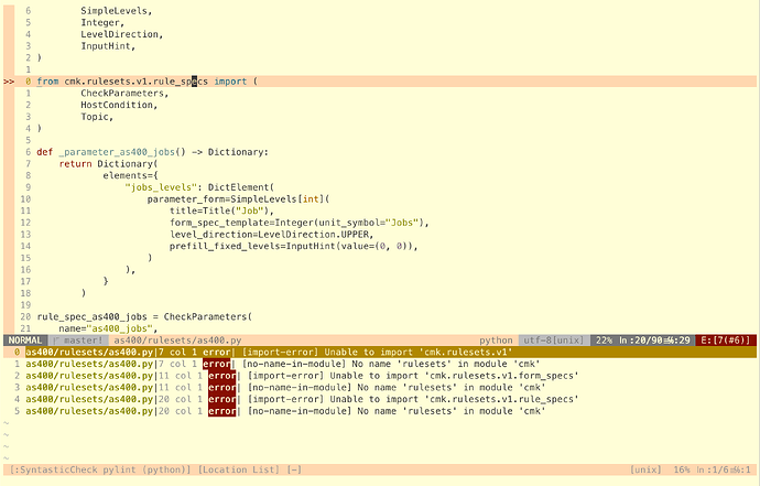

Is it possible, that currently the CheckParameters from the local rulesets are not loaded (2.3p1)?
I migrated my first check, the agent_based works fine (Checkmk-Checks/as400/src/as400 at master Ā· kuhn-ruess/Checkmk-Checks Ā· GitHub) , but the CheckParameters seam not be loaded. If I raise Exception() inside the file, I see the exception in the web.log. But when I put an exception into a parameter_form, there is no error in the log. I exactly followed the examples from cmk/plugins and have it basically same as there.
I think there is only a small typo in your file.
from cmk.rulesets.v1.form_sepcs import (
→ form_specs
Please don’t say that you also use some oldschool Emacs without syntax checking :wink:
After the fix, the rules are visible inside CMK
Damn, thank you very much. I was blind in the end.
No, I use vim and have autocompletion direct from the Checkmk repo so that I can check out different versions and always have the correct completion.
But right now, that’s not working since cmk.rulesets does not exist in that way inside the repo. Did not have the time yet to check where that path is and to fake it into my ENV. Which path are you using in your editor?
