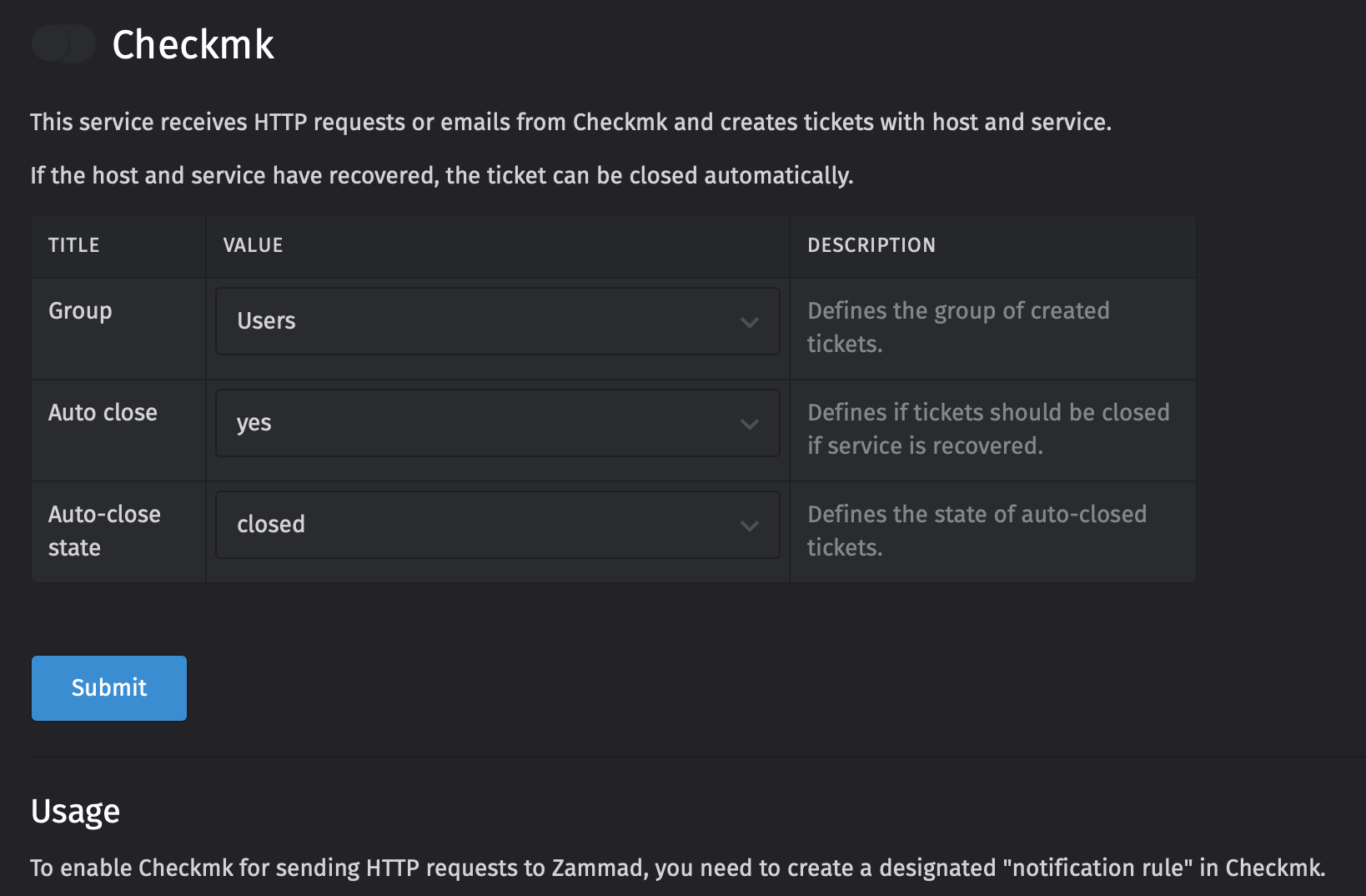

Hi, Im trying to config checkmk with zammad, I have this option for setup:
Im using Checkmk Cloud Edition 2.3.0p23
can’t see API host in Notifications > New Rule > Notification Method .
this is the Manual Setup Guide — Zammad Admin Documentation documentation
thanks
