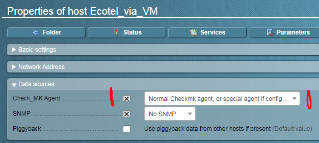

P.S.: I thought that this was an agent check, because I had to set the data source from the host in WATO to “Normal Checkmk agent”, activate an agent and deploy my python script in the right folder to make it work:
