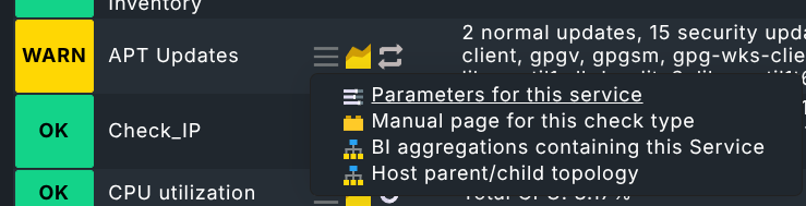

Behind the service name use the hamburger icon and then the “Parameters for this service”

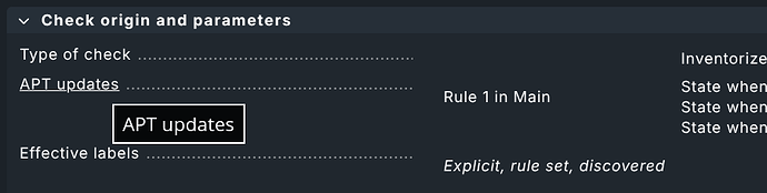

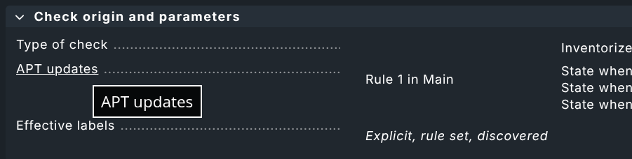

On the next screen every time the second option from top
goes to the rule set responsible to the selected service parameters.

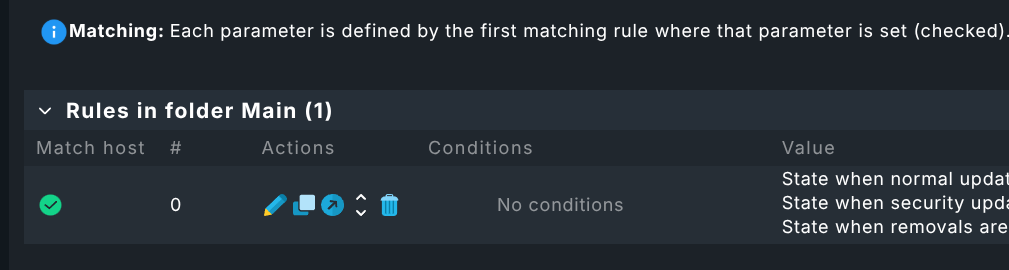

Result in my example brings me to this rule. If no rule is existing you should have an empty list here.
