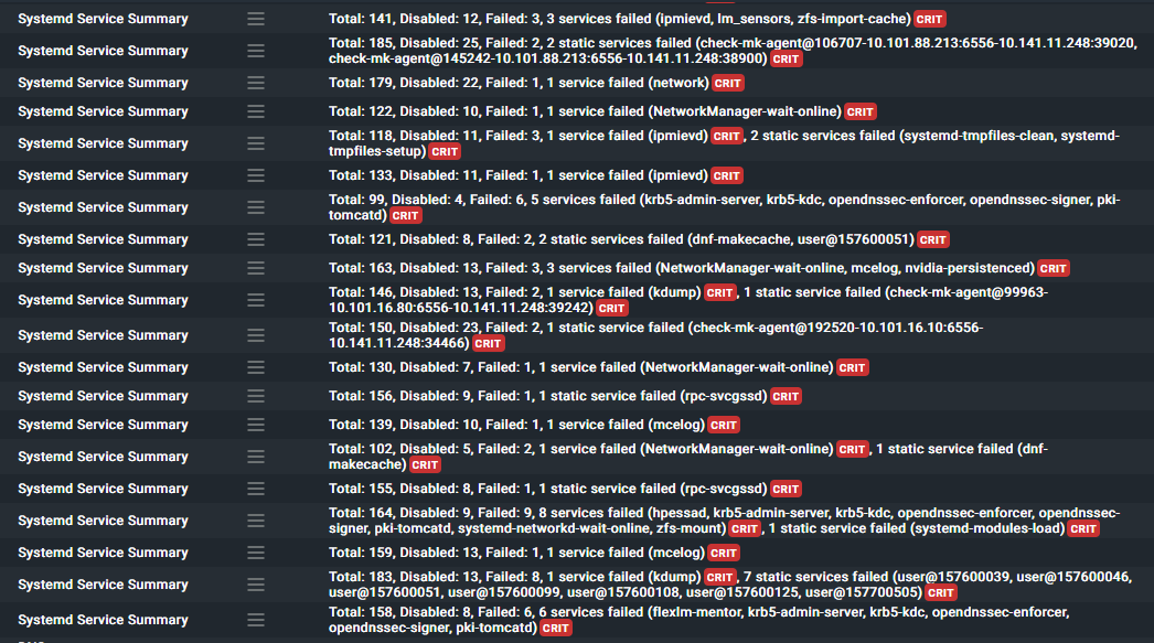

after updating the CentOS 7 agents from 2.0.0p9 to 2.0.0p28 (latest) we got many systemd service Crit Problems, which look like the following:

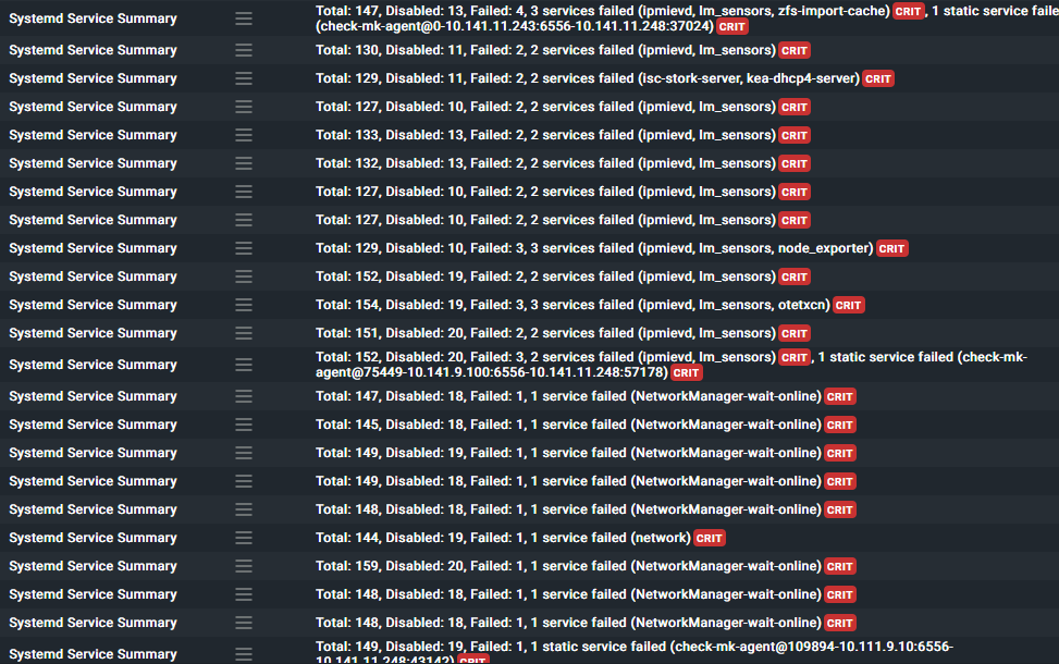

or

All these now Crit services were Ok with the older agent v2.0.0p9
Any idea how to deal with that?
Thanks!
