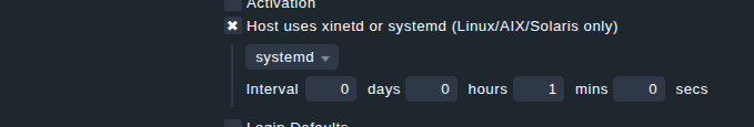

Are you using systemd and have you set this ?
We are using systemd, xinetd is not installed. We use the legacy agent und do not use the agent bakery.
As per the screenshot, you should put the agent plugin under the folder “60”. Is it already the case?
Yes
/usr/lib/check_mk_agent/plugins/60

Thanks for confirming. Could you increase that interval from 60 to 300 and see if this brings any improvement ?
Yes of cource. I set the interval to 300 now
Unfortunately, increasing the parameter to 300 didn’t help.
