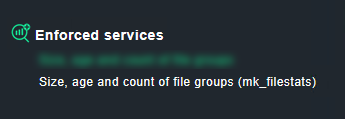

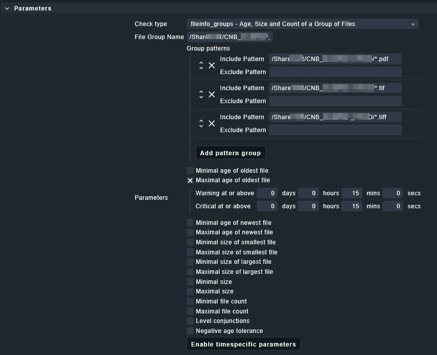

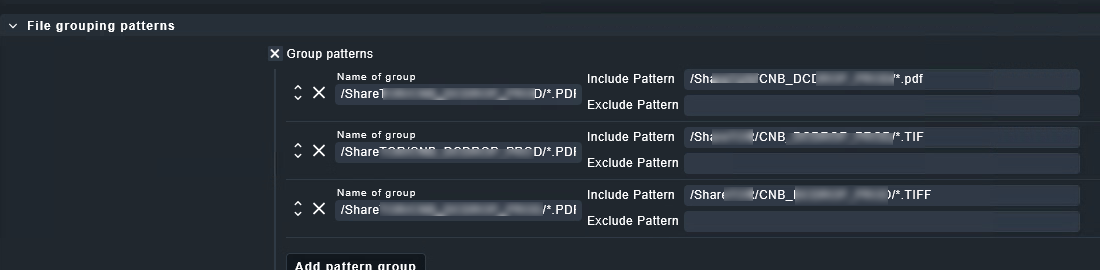

Also, create 2 rules for this monitoring in Check_MK:
1. File grouping patterns
2. Enforced Services–> Size, age and count of file groups
For now, I am only monitoring one path; when I tried with two, I created two pattern rules and two size rules—one for each of the folders.

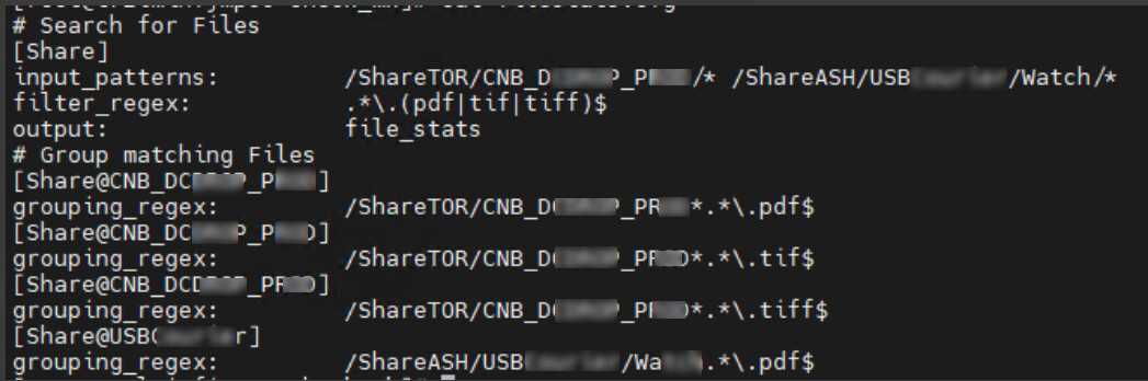

Hello LaSoe,
I configured it using the file stats method as you suggested and deleted the file info file.
I am providing evidence of the rules and the file.

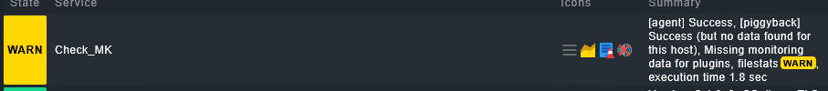

I used different rules than those for fileinfo in Checkmk, but it didn’t work; I am getting the error: “Missing monitoring data for plugins, filestatsWARN”.
Here I am, trying to monitor two different folders.
rules:
Linux server: filestats.cfg
Can you help me figure out if I’m doing something wrong?

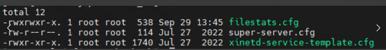

Did you deploy the mk_filestats.py plugin onto the server?
Once the plugin is on the server, you can run it directly from the console to check what it picks up. For more details, you can use -v or -vv, and for testing purposes you can use --config-file to test with a different config file.
Thank you very much, La Soe; I installed the plugin, and the monitoring worked.
