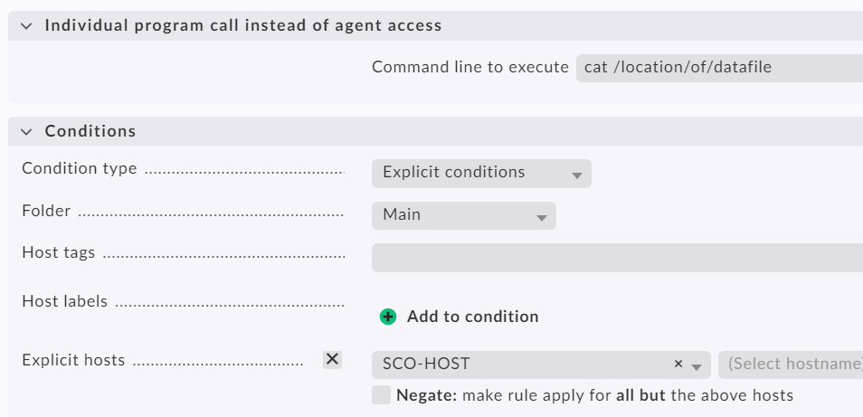

You can create a âIndividual program call instead of agent accessâ rule
like this
this file must be readable by the CMK site user.

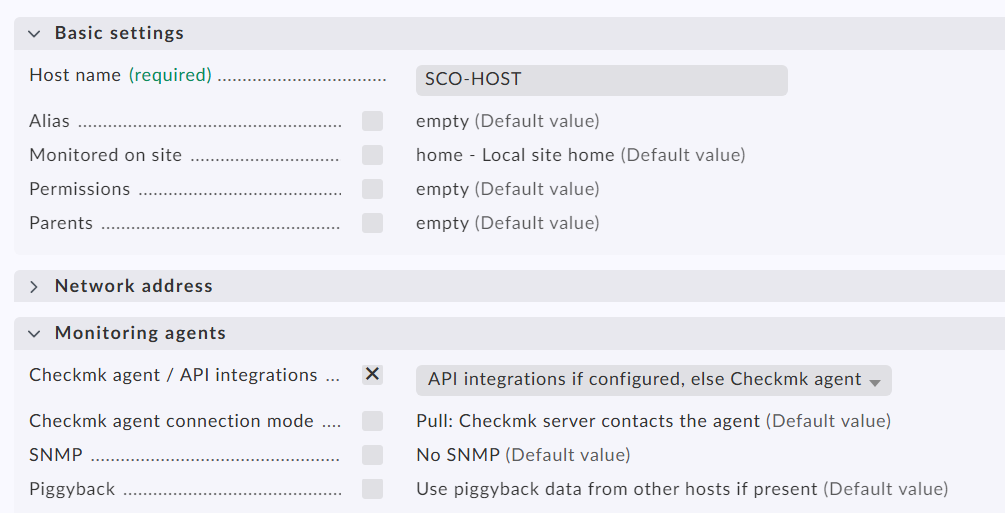

The setting for the SCO host should look like this.
Now you can do a discovery - if the data inside the file correspond to normal agent data something should be found.
