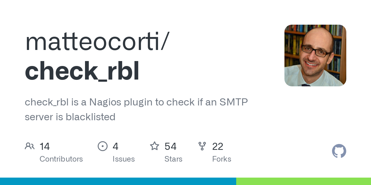

This is the plugin i use:
Isn’t -t 60 a 60 seconds timeout?
You are right. Ik so sorry did not know it was an option.
Now i use the -t 120 and it works every time.
