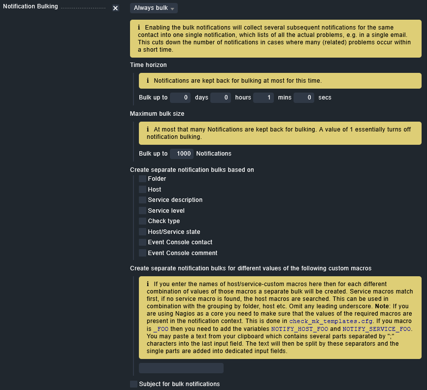

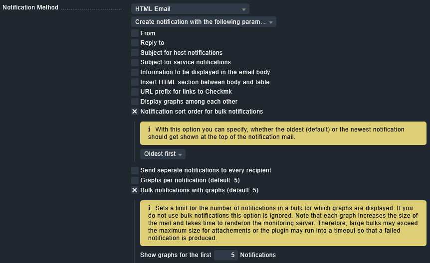

You can do Notification Bulking. Then you get bundled notifications based on the conditions, like Time horizon or Create separate notification bulks based on, you set. You still get the flood, but categorized in less mails (or whatever notification method you configured).
See Setup > Events > Notification configuration > Add notification rule
And there are some extra settings in the part above this:
My screenshots are from 2.1.0p5.cre, so they might look different on your system.
