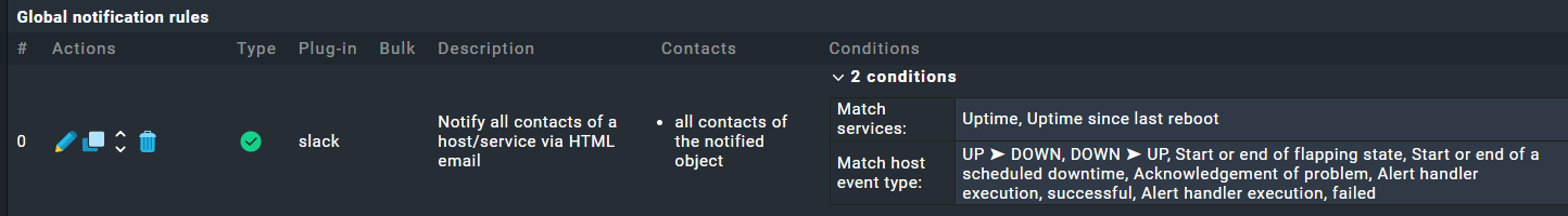

I configured the notification rule to get notified when the machine was rebooted or down but unfortunately, I didn’t get any alerts to be notified to my webhook end point.

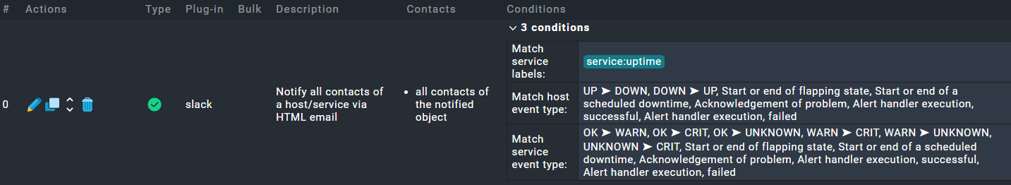

I think Match service event type is missing. Which event should send the notification!
Thanks for response, I have tried with the 'service event type ’ as well but didn’t get any alert.
Please check if the service search shows the service uptime, if you filter for the service label “service:uptime”.
Instead of using the match service label, you could use Match services.

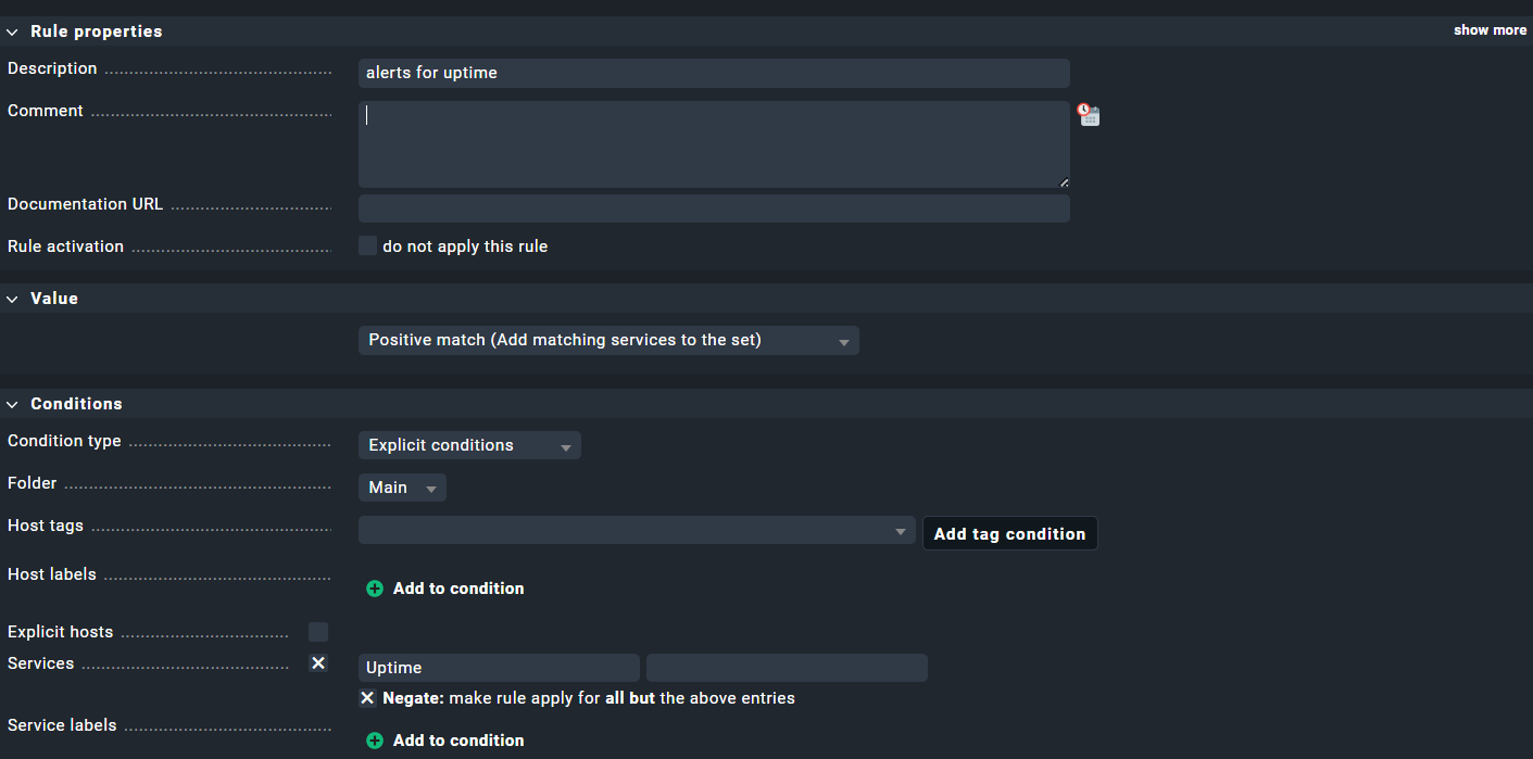

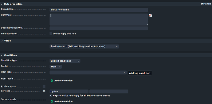

I figured out how to monitor a single service like uptime by using the configuration below.
