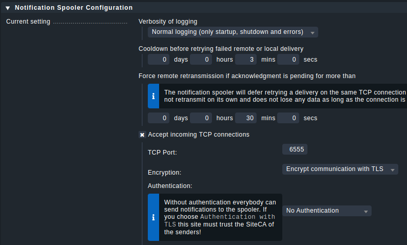

Hi !
When I configure the notif spool on a remote site I can enable authentication
But what authentication is used ?
If I enable the inline help the auth is done using the certificate, but when I select this option it fails
Although my site is connected and the ssl uses trusted certs

our setup meets both conditions but doens’t work
and configs are pushed from central to satelite
