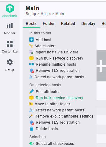

For one switch, it’s fine, and that’s what we do, but how do we do it for several at the same time? (currently several hundred switches with this problem !)
Regards
Xavier

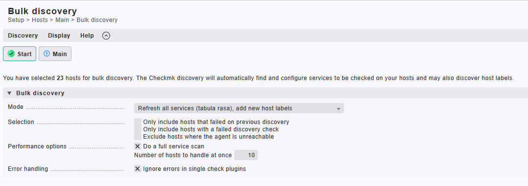

You can try a bulk discovery for those switches. Select the hosts you need and then choose “Hosts” → “Run bulk service discovery”
From there you can select to run "Refresh all services (tabula rasa). That should do the trick.
