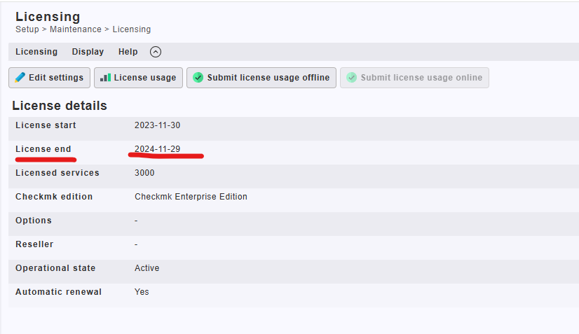

We’re using Checkmk Enterprise Edition 2.4.0p14 and have subscribed to the Enterprise Edition using the offline activation method.
However, the license information still displays the old license date, as shown in the screenshot.
Could you please advise on the exact steps required to resolve this?
Offline means that you need to manually do everything. Nothing can happen automatically, if it is offline mode.
I’d recommend to just switch to online licensing and allow your Checkmk server to speak with the Checkmk license server.
is online way available for Enterprise Licensing?
You are on enterprise (probably).
Both online and offline license verification is available in enterprise.

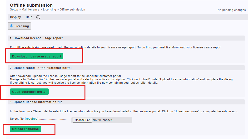

HI Martin
I have last year’s usage report and the response file that we uploaded to the Check_MK dashboard. I remember using the method shown in the screenshot to upload both the usage report and the license response.
Could you please suggest if any step might have been missed in this process?
Manual process → after your subscription renewal, you need to do this again.
If you don’t want manual work, go to online verification
hi Martin
Thank you for your response.
Just to confirm — do you mean I need to repeat this process, and then the correct license information will appear?
  1. Download the license usage report from the Check_MK portal
  2. Upload the license usage report to the customer portal
  3. Upload the response file back to the Check_MK portal
