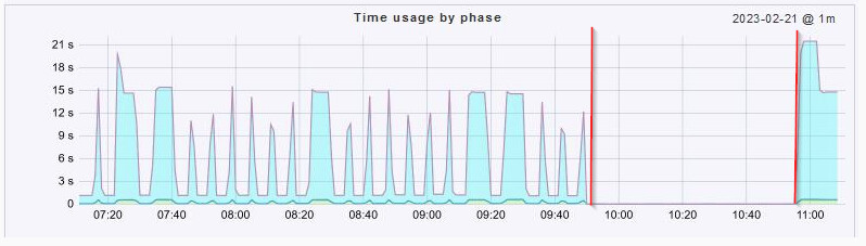

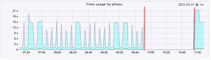

Here is the Check_MK graph of the mentioned host.
Note the zigzag, then first red line is first “Remove all and new”, then nothing until second red line where i did the second “Remove all and new”. After this, the looks of the graph changes.

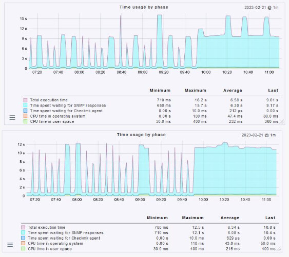

And here are two “Check_MK” service graphs of two of the other affected hosts. Note how the graph changes after the first “Remove all and new” on the beforementioned host:
