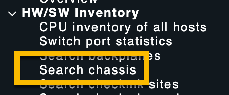

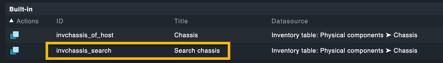

have you try to list and export over the invchassis_search ?

Do you have edit the view to Show the HW informations?
