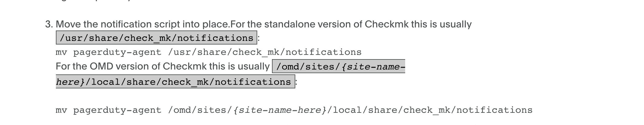

My guess is that depending on how I install checkmk, the location where I put the Notification script will change.
If you know pagerduty, you will understand by looking at this. This guide describes how to integrate Checkmk
What they call “standalone version” sounds like some manual installation from a source archive.
If you have installed Checkmk following the official documentation, then you have what they call “OMD version” and you should use the local path for any local addition.

But if you look at the reply of Elias.voelker below,
Do you know what this means?
@elias.voelker used that term in quotes. Surely he meant “standalone setup” instead of “distributed setup”.
You install the software package for your OS (.rpm or .deb) and then use the omd command to create and manage a monitoring site (instance). Please see the docs for more info on installing:
… as well as the links Elias already posted.
