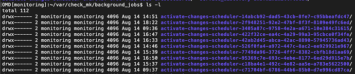

I removed these and now it activates:
Just a note: It looks like the changes to be activated, or the background jobs were corrupted. Maybe due to a full disk? But the important thing is, that you are up and running again.
