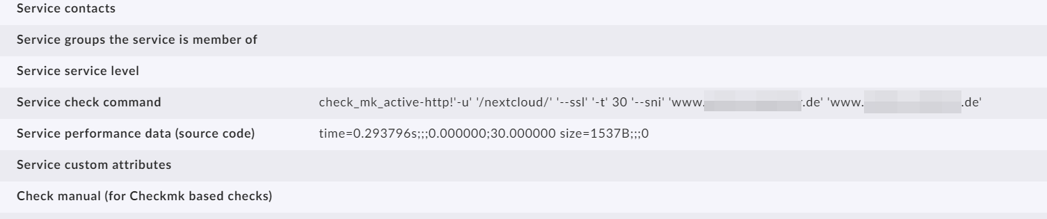

Beside the suggestions from @bmst you can also have a look at the command line of your configured check.
These command line option can be used exactly the same with the “check_http” to test and modify.
