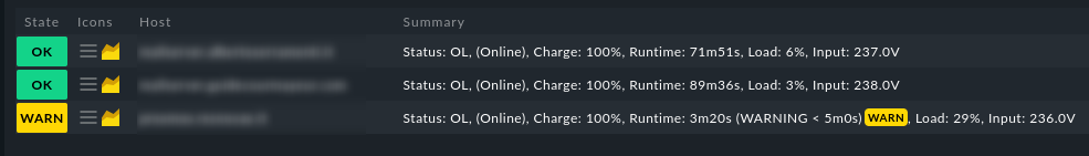

I created a version of nut.py compatible with Checkmk 2.4.
It’s very basic, but it seems to work.
I don’t rule out errors, especially with non-standard values.

i am using this extension as well and tried to update it. Found your thread so here is my take on it GitHub - virus2500/checkmk_nut: NUT extension for checkmk
Here is the mkp for it.
nut-3.0.1.mkp (7.0 KB)
Maybe you can test it on your end. Works good on my side.
The github workflows aren’t working atm… haven’t really looked into them.
It’s just a first try so … beware of bugs :wink:
br
Thank you for the work you did, it works perfectly for me as well.
:top:
