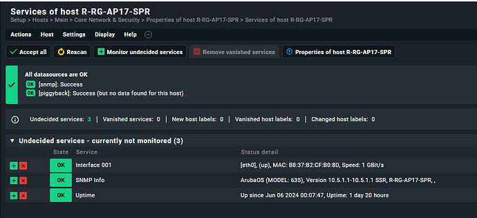

What do you see after adding the WLC with correct SNMP configuration inside the service discovery?
This is all I get from a correctly configured snmp community string
You have an Aruba instant WLAN access point. For this device you need other checks.

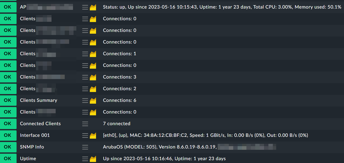

Result will be like this on a slave AP.

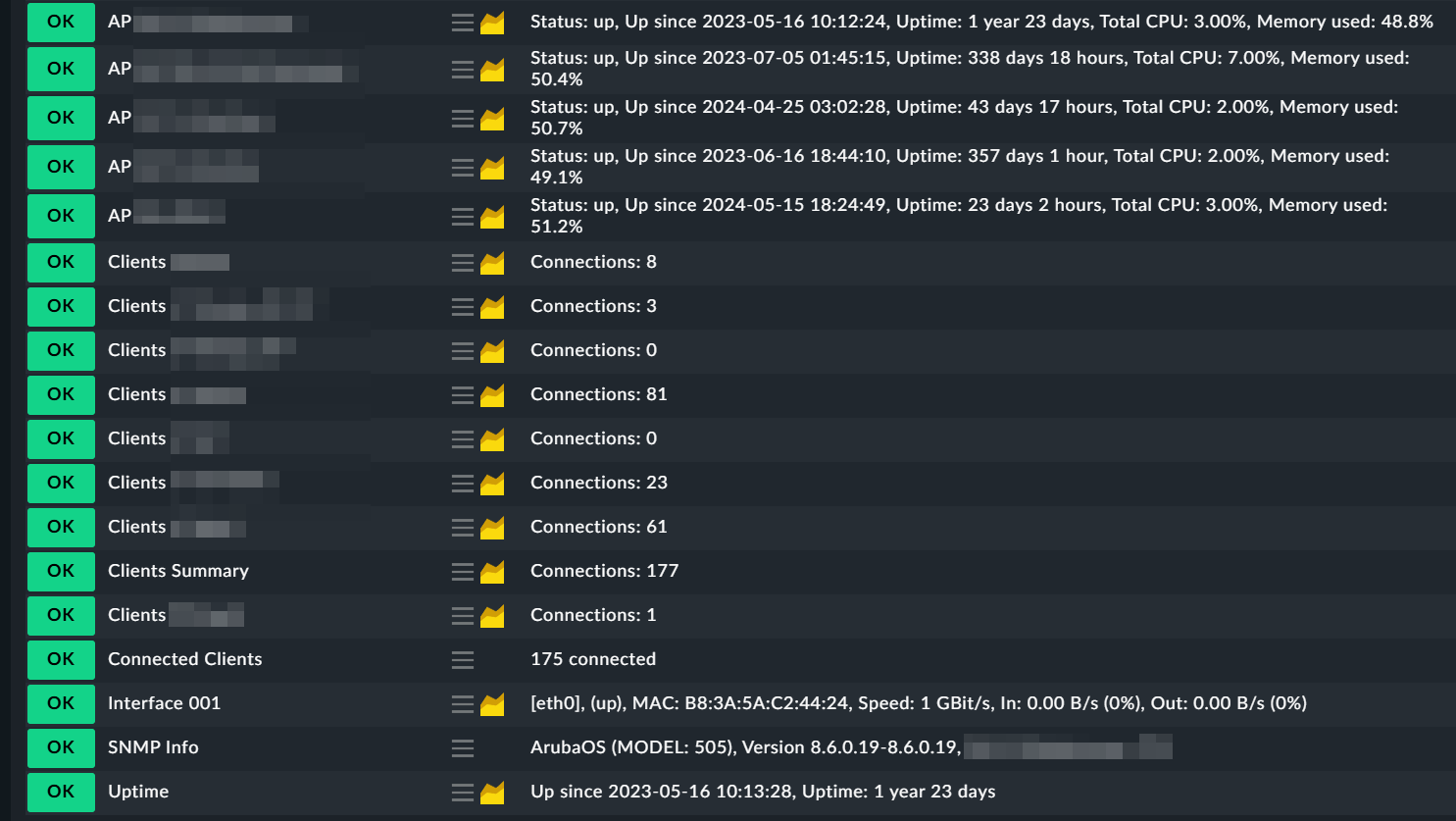

On the master AP you will see the status of all other APs.
And also all connected clients.

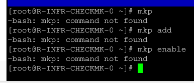

Sory if im being naive, but I cant run any sort of mkp commands
Screenshot 2024-06-07 175010

you have to run those commands as the site user.
After logging in as root, run omd su <yoursitename>

On the controlers IP those new metrics don’t show up…?
This mkp is only made for Aruba instant WLAN. There you normally have no controller. It exists only a master AP that shows the data from all other APs and his own.
afterall installing the latest mkp and enabling it succesfully, still not dont see the above. what did i do wrong? :frowning:
Is your system really a Aruba instant WLAN AP?
If not it is possible that it will not work.
