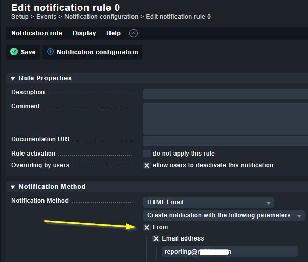

I’ve found the solution for change FROM address: from WATO Setup-Notification then under Global notification rules you can chage it!
Thanks!
Will check it out after the weekend if this will work with MS issue as well, looks promising.
