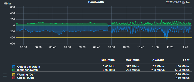

i just updated my check_mk to version 2.1.0p11.
After that my graphs are looking different with some spikes.
The SNMP check interval for this host is 1 minute.
I cannot say what the exact reason is, but to me the values look withing expected range.
So your only issue here are the looks of the graph?
Yes only the looks of all graphs is my issue.
I didn’t change any interval after the update to the new version.
And I am certain this has noting to do with the interval.
I would consider this a change in graphing or the interpretation of values.
Do you know how i can change it?
There is no changing it. I think this was introduced with Werk 117220, which improved the graphing. There is no error here, we just improved the level of detail on the graphs.
