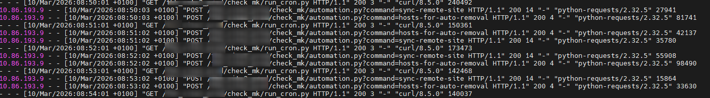

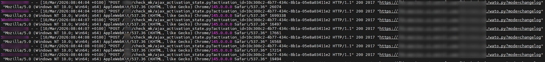

I also performed an activation for all sites again and only saw the following call repeatedly appearing in the access logs.
Master:
Site:
