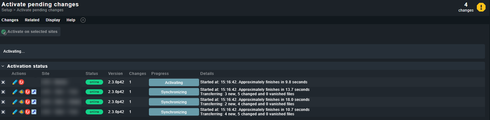

After adding the KPC package and running “cmk --debug -vvU,” I received no errors. I then started the site to access the UI. There was a change in the log that still needed to be activated, which I did. However, I waited 10 minutes and got stuck on this view:
I deleted all existing activations there. After that, I activated each site individually, and it worked. Therefore, I genuinely do not understand this behavior. For my colleagues, this is a no-go, and they want to roll back because the current workaround of activating all sites individually is not an option for them.
What could be causing this behavior? The sites remain in the “Synchronizing” status, thus blocking further possible activations.
