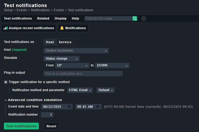

I don’t know if the log exists on Raw, but check your site var/log/ directory for logs about notifications. In CEE and CCE, the files are mknotify.log
Hopefully there will be some additional details there.

Have you tried the test notification tool? You can tell it to send the actual alert email (so you can hopefully get as close to a real notification as possible).
(Taken from fresh 2.4.0p9 RAW site)
Also, you can force a fake check result as another way to test. A bit more combersome, but if the test notification tool doesn’t trigger the error, you can try that.
