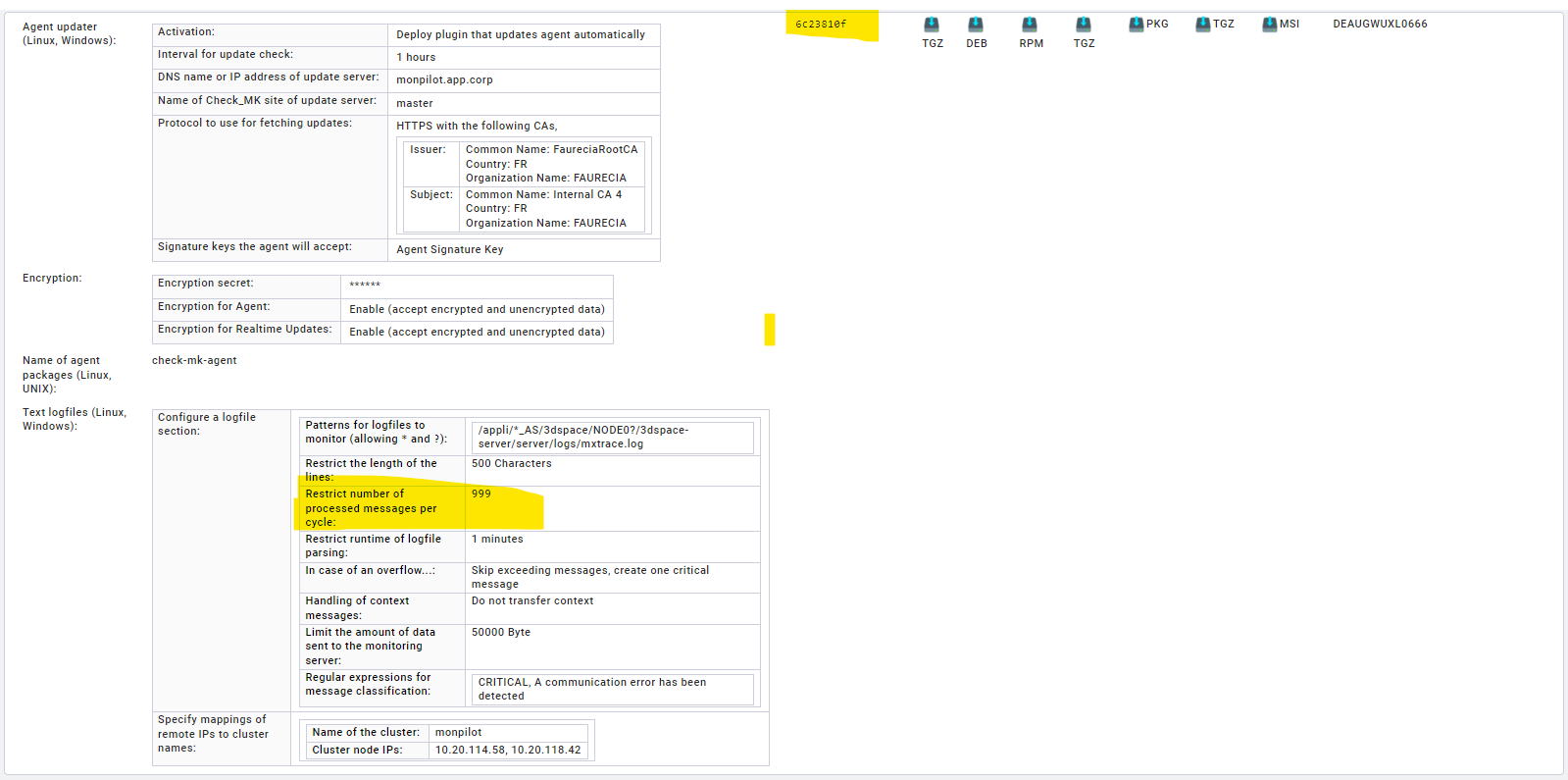

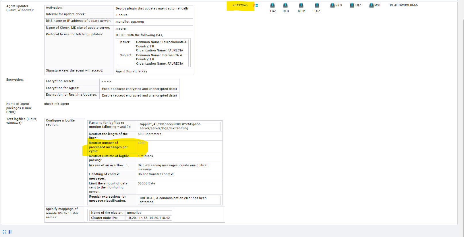

Agent baking could be forced and debugged on CLI with cmk -A. or with the button “Bake agents” but only if you change a bakery rule you will get a new hash and a new agent is baked.
So if you changed something in the rule “Text logfiles (Linux, Windows)” your button ‘agent’ becomes highlighted. If you now bake new agents you will have a new hash for the new agent package:
Before modification:
** After Modification**
Funny enough if you change the configuration back to what it was before you get the exact same hash as the configuration had initially. That´s perfect because then no new agent is rolled out in case you made a mistake and need to roll back. In an environment with tens of thousands of hosts it would be a nightmare.
