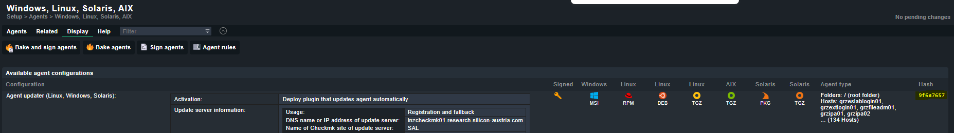

I want an explanation why the shown hash 9f6a7657 in WATO
differs when I download the rpm package:
why the difference?

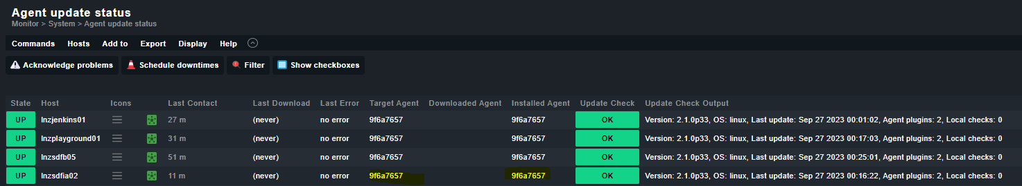

and I compare this output to the panel:
that also doesn’t fit together. The installed agent hash in this picture is completely different than the target hash (the one, the checkmk server would deploy to the node).
btw, the node is error-free registered.

The hash its the same, the GUI only show the first part of the hash!
me stupid, I was looking at the end of the hash string … :see_no_evil:
