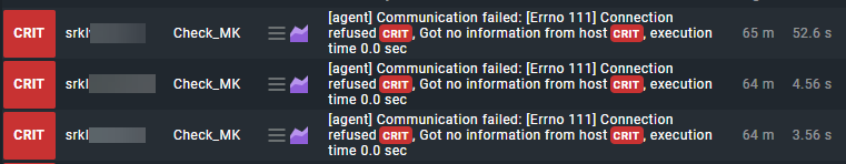

I just installed the new CheckMK version 2.1.0p1. After that the three linux hosts get the problem back.
I will make your workaround again for theese three hosts.
Bye, Sascha

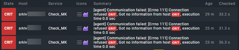

I installed version 2.1.0p4 today and I still have the problem with the agent with two Linux servers. Could only solve it with Mattias’ workaround. Shouldn’t the problem have already been solved with p3?
Bye, Sascha
And the same with Version 2.1.0p5.
