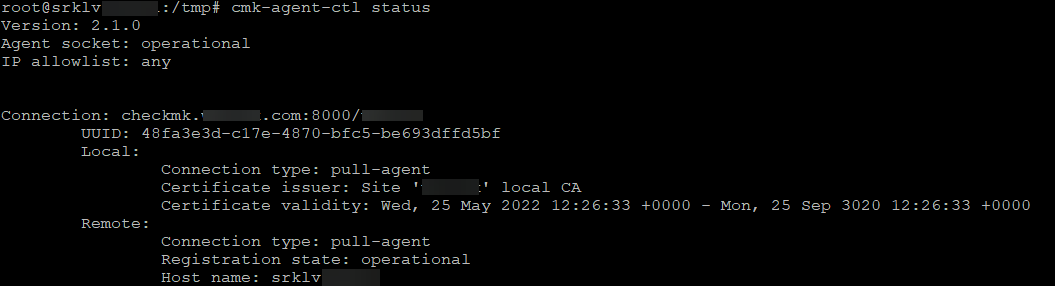

For the Linux hosts: Is the agent controller running? ps waux | grep cmk-agent-ctl Might the hosts be limited (by boot parameter) for a strict IPv4 only setup? Or might registration for TLS has been failed? You can check with cmk-agent-ctl status.
Just in case: We are prepared for cases where the agent controller cannot be started or crashes. You could switch to xinetd mode and disable systemd services for the agent controller while we are investigating:
Here the outputs of the two commands
I think this looks good.

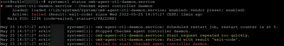

Registration indeed is good. But if cmk-agent-ctl cannot be started, access fails. This might be a bug. Please provide me with the output of:
systemctl status check-mk-agent.socket
systemctl status cmk-agent-ctl-daemon.service

I need another one:
But I just switched to xinetd mode. I hope this is no problem for this output.
Thanks, that’s useful. Just to leave everything clean and have no conflicting services left, please also do:
systemctl stop cmk-agent-ctl-daemon.service
systemctl disable cmk-agent-ctl-daemon.service
