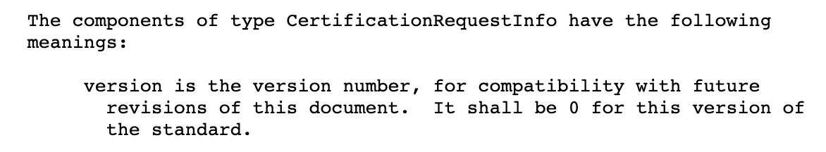

The standard of CSR definition is describe in RFC2986 (https://www.rfc-editor.org/rfc/rfc2986) and affirm that the version of CSR must be 0.
This is a bug of the client cmk-agent-ctl. The client must set the version 0 for the CSR
