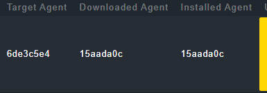

should the download and installed agent different from the target agent?
@rprengel
Oh yeah, it should because its not updating yeah
Hallo,
nope all 3 IDs should be the same if every thing works.
