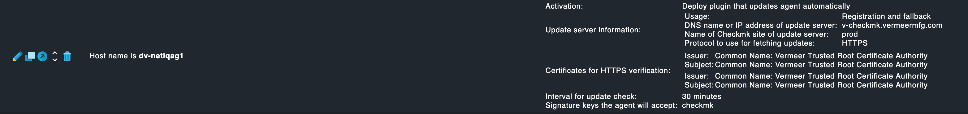

Details: We have a few sites (see below for site details). The VMs in the DMZ cannot talk to our central site, but can talk to our DMZ site. The DMZ site can talk to our central site over port 80, 443, 6556, and 6557. I believe we have the site settings and agent updater agent settings set so that the distributed sites know to reach out to the central site to pull agent updates, but I’m seeing the following error (see cmk-update-agent -v output). These two sites have existed since before CMK v1.6 so it’s possible that something is missing that is normally there on more recent installs, I just don’t know what that is.

Agent Updater agent settings

The forum won’t let me add more than one embed per post, so the settings are written out.
