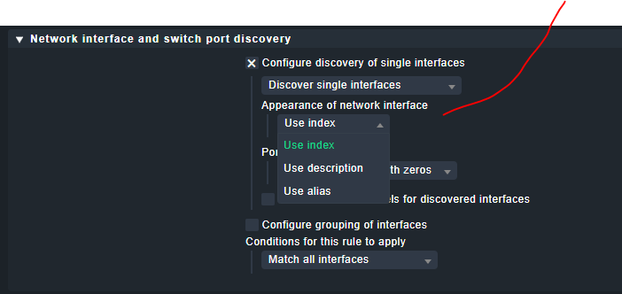

for that you can create a new rule:
Service discovery rules > Network interface and switch port discovery
and use the Port description like it set in the switch or router

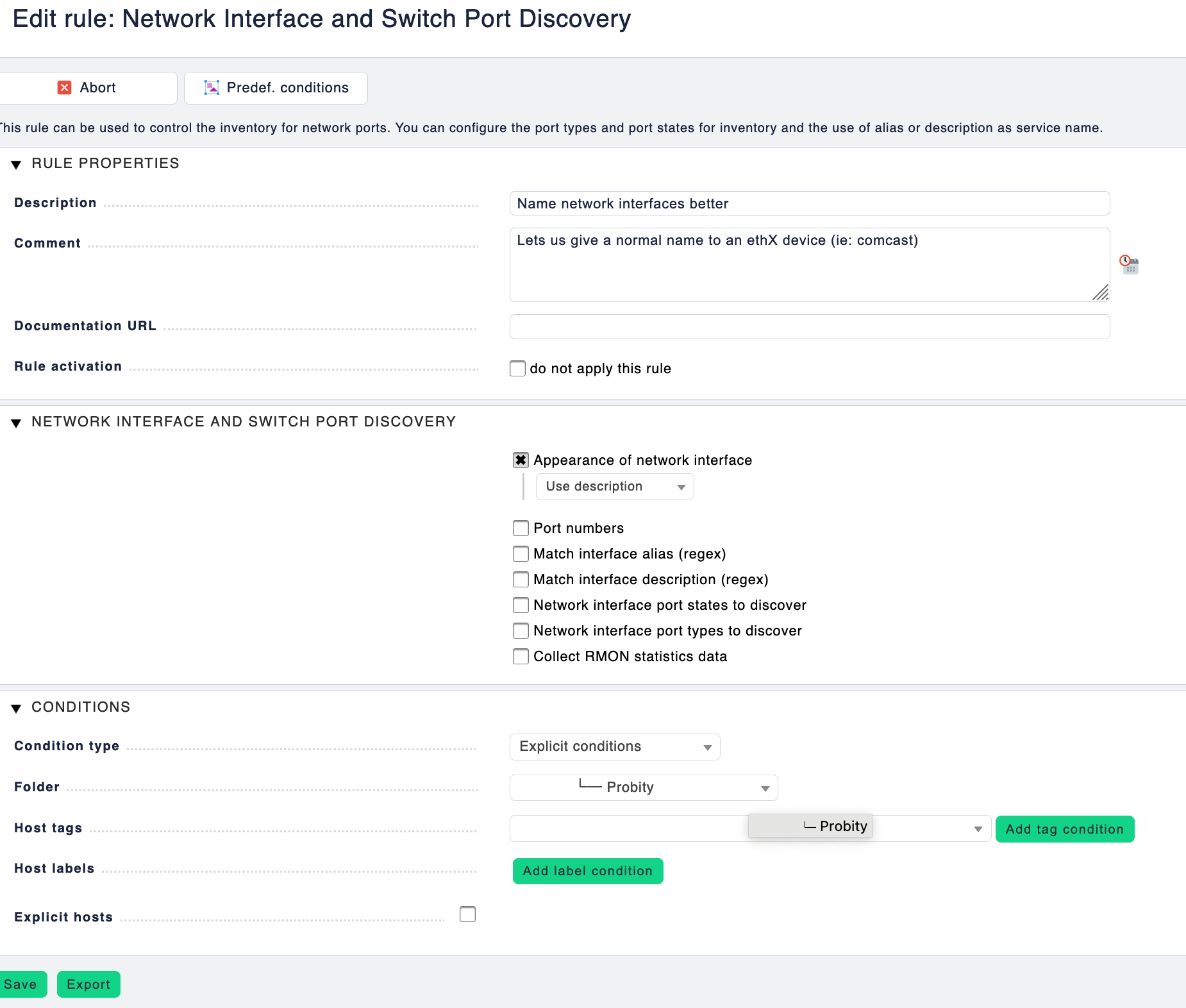

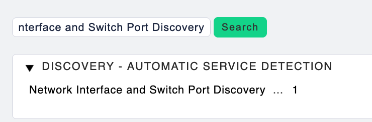

So maybe I’m just too much of a newbie here, but I’m not seeing what you’re seeing. I go to WATO, main menu → Host and Service Parameters, then in the search box put in “Network Interface and Switch Port Discovery” and it gives me:

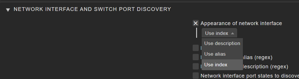

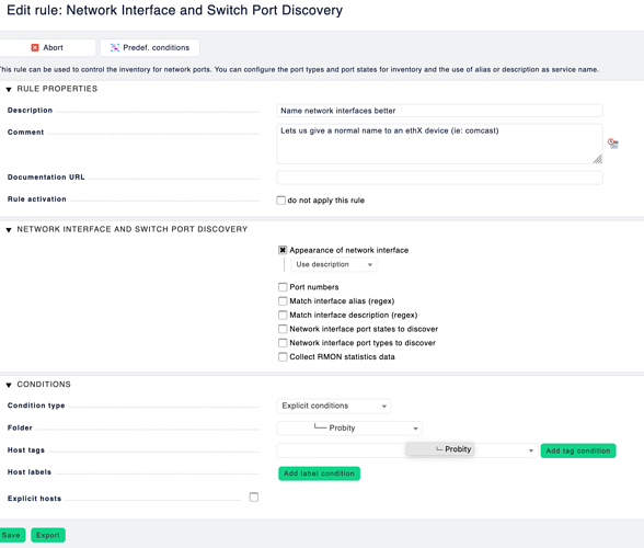

Click on network interface and create a new rule (the 1 in the above screenshot is me having done this before). I see the header and similar to what you’re seeing (I’m on 1.6.0p14), but only the ‘appearance of network interface part’.

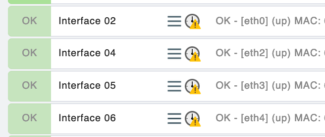

I did create a rule as in the above screenshot for a single folder with a single host, went into there and it did show me new interfaces to monitor and unmonitored interfaces, so I did the full refresh and now in that host I have all the interfaces still named the same, but with no data received, and no (apparent) way to edit the services on the host to add the name.
Am I in the wrong place here or am I misunderstanding what this feature can do (or that it’s not able to do what I am hoping I can do)?
Note: I am wanting to add a label by hand through the CMK GUI, not pull in descriptions from the switch/router - which on re-reading seems like what this would do. I’m not wanting that, I am wanting to add a label on a per-host basis almost like a tag onto the interface name.
