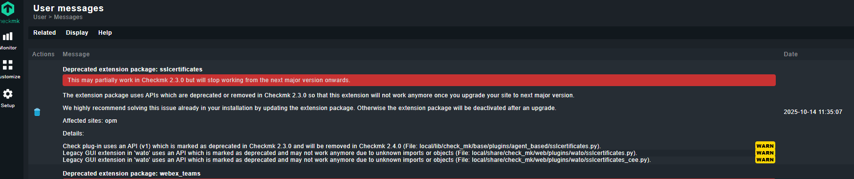

In Checkmk i have found the follwoing message:
