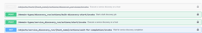

Google results for error 302 says “the resource has been temporarily moved to a different location” - but this cannot be…? It’s exactly the same path as this thing suggests:
Edit: One observation: This only happens with mode refresh. Mode new which is supposed to run after refresh has result 200 and works.
This seems to be the answer:
So it’s a fake error, just need to configure it as expected instead of 200.
