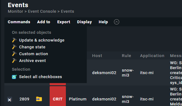

The Event Viewer archiving of events does not work properly. It only archives the oldest event and not all of them.
When I look at “Monitor > Event Console > Events” I see seven events from event #15293 through to #15299.
If I got to “Commands > Archive Event” and get this dialog:
I select “Archive” then I go back to the view, and only the oldest event #15293 has been archived. The other 6 are not archived.
So I have to step through this multiple times in order to get all the events archived. Very tedious. It is only a recent regression in this version and I think the previous one. Please fix. Thanks.

Can you try replicating this using the Checkbox option? Are you using a custom view? I`m using this option to archive events heavily in 2.3 without any issues.
Makes no difference if checkboxes are enabled, and multiple items are selected.
No.
Indeed - it used to work fine.
