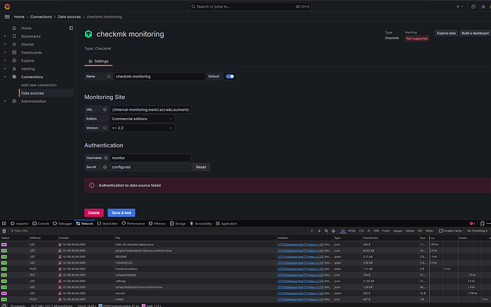

I am trying to integrate Grafana to Checkmk CEE but getting errors at the last step.
I couldn’t figure out what was causing this issue. I have attached the error below. Is anyone having this issue with tribe-29-checkmk-datasource-3.3.0 with Checkmk 2.3.0p19?
I assume your Grafana server can reach your checkmk server on the LAN?
Not sure if :// is supported (Generally should) have you tried https? - Does the Grafana server trust the cert? (have you tried curl from Grafana?)
What does the checkmk web.log or other logs say when you test the connection ?
Hi Anders,
The user of the checkmk was incorrectly configured with different roles. It has connected now and is working now.
