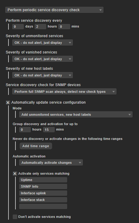

anyone else having problems with auto discovery and not already found services?
We have one auto discover rule for network interfaces. Specific called interfaces should be added to the monitored services. This is working perfectly if you do an manual full scan on the monitored switch. But its not working at all automatically.
We have the same problem with an tabula rase rule. We want to get rid of a lot of services. But its doing nothing.
