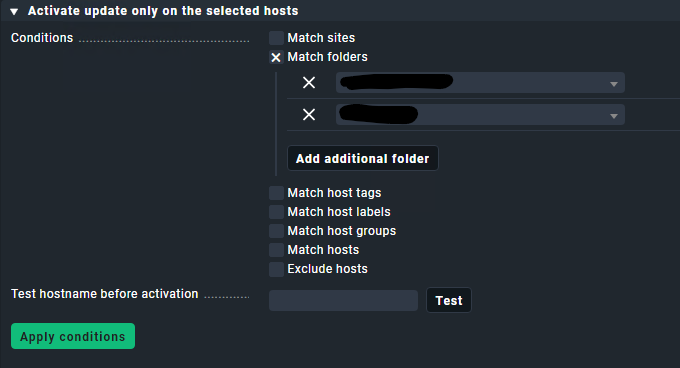

CMK version: 2.2.0p32
I have setup automatic agent updates.
But I want to limit it to some host for Test deployment, so new agents are only deployed to these host.
So, I can do a controlled rollout to like 4 host groups.
But if I select update only to the selected hosts, then all other agents with automatic agent installed, will get a warning i “Check_MK Agent”.
Is there any way to avoid this_

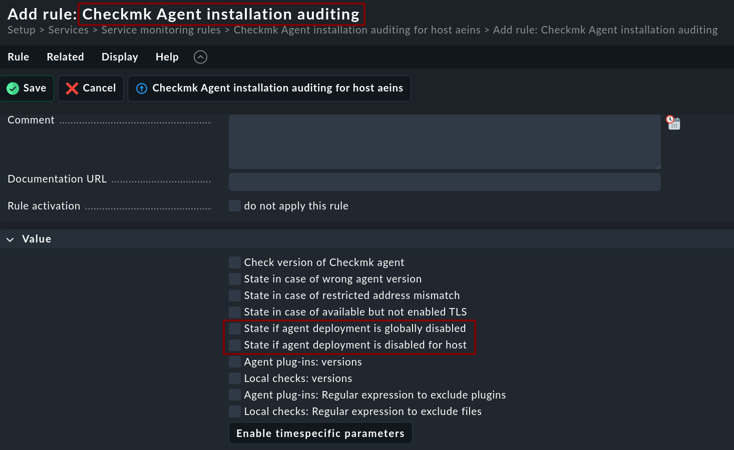

Hi Denis,
in the rule “checkmk agent installation auditing” you can configure the following rules :
State if agent deployment is globally disabled
State if agent deployment is disabled for host

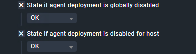

Thanks, so if I set it to
State if agent deployment is globally disabled: OK
Then the warning will be gone and the service will be OK?

But I will get an error on the host that has installed automatic update and is not in that folders.
Is there any way to avoid that alarm?

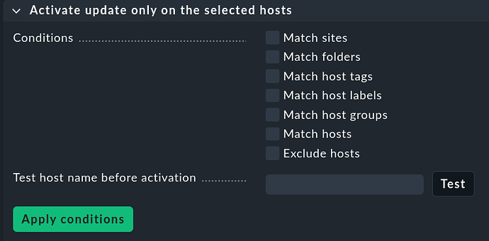

Hi @denis ,
do you mean something like this?

Yes, when I apply that, host not matchning the Conditions make an alarm

Hi @denis ,
the rule Checkmk Agent installation auditing should solve your problem:
Karl

I have set these, and that only work for the “Master switch”
But now when I have activated the master switch and made Conditions to groups all other servers starts to get warning
