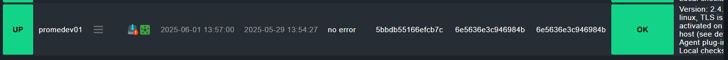

After a few days, the updater stops emitting any errors, but also stops attempting to communicate/update entirely. For example, on 2025-06-03 the log only shows:
2025-06-03 11:48:00,588 [2563505] DEBUG: Starting Checkmk Agent Updater v2.4.0p2
2025-06-03 11:48:00,589 [2563505] DEBUG: Successfully read /opt/checkmk/agent/default/package/agent/agent_info.json.
2025-06-03 11:48:00,589 [2563505] DEBUG: Successfully read /opt/checkmk/agent/default/runtime/cmk-update-agent.state.
2025-06-03 11:48:00,589 [2563505] DEBUG: Successfully read /opt/checkmk/agent/default/package/config/cmk-update-agent.cfg.
2025-06-03 11:48:00,589 [2563505] DEBUG: Updating the certificate store "/opt/checkmk/agent/default/runtime/cas/all_certs.pem"...
2025-06-03 11:48:00,593 [2563505] INFO: Updated the certificate store "/opt/checkmk/agent/default/runtime/cas/all_certs.pem" with 3 certificate(s)
2025-06-03 11:48:00,594 [2563505] DEBUG: Running agent updater in InstallMode...  Found no pending agent hash for installation. Nothing to do for us.
2025-06-03 11:48:00,594 [2563505] DEBUG: Done.
But notice that there is no “agent package file” being fetched or applied after 2025-06-01 (i.e. no further communication with the deployment server).

  • Immediately after registration (running under cmk-agent), on the first few runs of cmk-update-agent we see:
ERROR: Content of the state file is corrupted or inaccessible. Falling back to backup state file …
despite the state file having correct ownership and mode (-rw------- cmk-agent:cmk-agent).
  • After a couple of days, the updater stops logging errors but also stops attempting any updates. Even though the central bakery has published a newer agent package, the updater reports “Found no pending agent hash for installation. Nothing to do for us.” In other words, it never re-contacts the server looking for new versions.
  • This is consistent across multiple servers when the agent is installed and registered under a non-privileged account. We did not register as root (because registering as root prevents auto-updates entirely), so there is no mixed-permission setup. Everything under /opt/checkmk/agent/default/runtime/ is owned by cmk-agent.
  • We do not see any SELinux denials in /var/log/audit/audit.log.
  • If we temporarily switch to registering/updating as root, the updater fails entirely (refuses to run), so the only way we can keep automatic updates is under a non-privileged user—yet that user’s updater run produces “state file corrupted” errors.
  • Once the initial “corrupted state” errors clear (takes few days in our case), the updater never again attempts to contact the bakery (no “Fetching content” lines after 2025-06-01).
  • I have set interval for checking for updates to 3 minutes (it’s for test/devel purposes)
